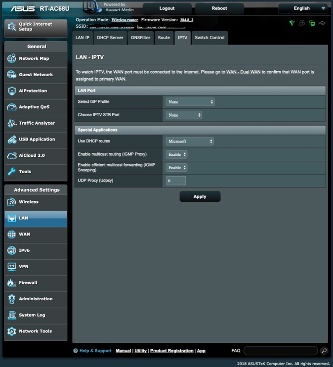

On my FreeNAS - I stopped the Plex Jail plugin and on my Asus WRT Merlin flashed router- under Advanced Settings - LAN - IPTV - Special Applications - I enabled multicast routing (IGMP Proxy) as well as Enabling efficient multicast forwarding (IGMP Snooping) (see attached photo). I rebooted my router for good measure and after started the Plex Jail Plugin on my FreeNAS. The guide data refreshed without a problem afterwards.
