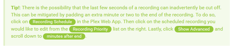

The padding is also a suggestion on the comm skip plex page so play with it and see what works best for your specific situation. this link has info on how to locate and modify the ini and you can use any of the commskip ini stuff documented here
https://support.plex.tv/articles/115003944134-removing-commercials/
