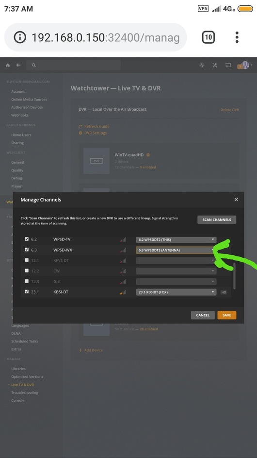

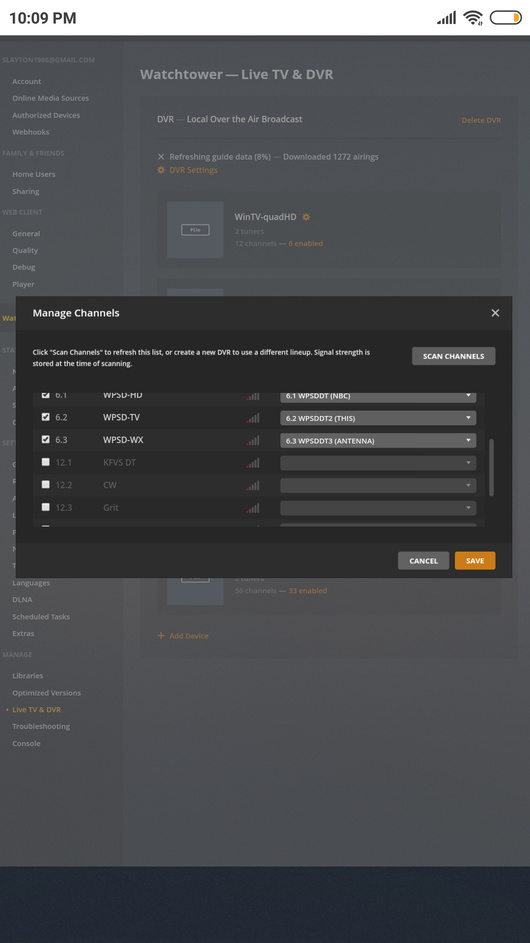

Found a temporary workaround for this issue. I have 2x wintv-quadhd tuners and one Hvr-2250. Unchecking the channels in tuner setup is not enough. Re-enable the channel and on the guide channel portion, click and scroll to the top of the list to were it says select channel. Do this for each channel you do not want tuned and then disable them. Might have to restart the server for it to work. It won’t tune the wrong tuner anymore as there will be no guide data mapped to the channel on that tuner.

What do you mean the guide channel portion? I have been disabling channels in the manage channel section as you have pictured in your post but that does not work.

Under manage channels. You have the tick box to select or deselect the channel. Then a column with the channel name. Then the third column is where you can select the guide data mapping. If you click on that you can scroll up to the top of the list to where it says select channel. Then untick the channel in the left column and save changes. Will need to restart server afterwards.
