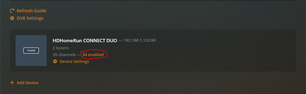

Just to make sure, you’re not mixing the terms Guide Refresh and Channel Re-Scan?
A Refresh guide does nothing if your channels have all changed frequencies, you need to tell plex to re-scan (which it does during removing and re-adding the tuner(s)) You can also re-scan the channels by:
