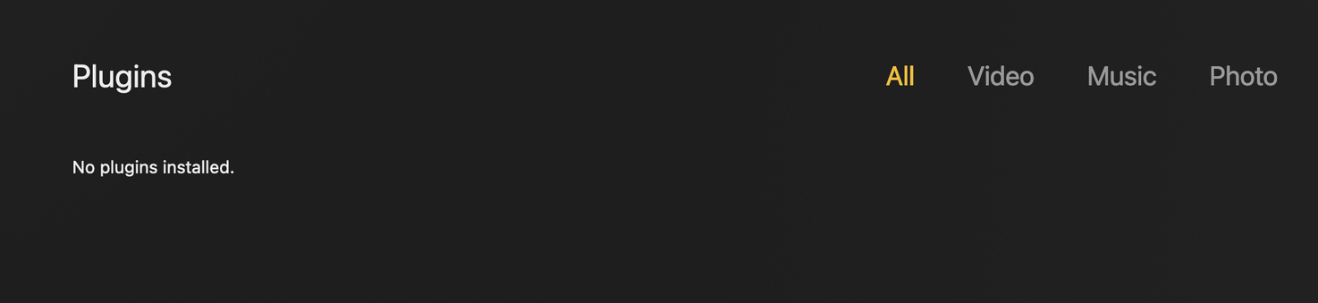

Use a different browser for a moment or turn off the plug-ins.
They’re sending bad request(s) to Plex

No plugins installed on the server. Are you referring to other features in settings?
