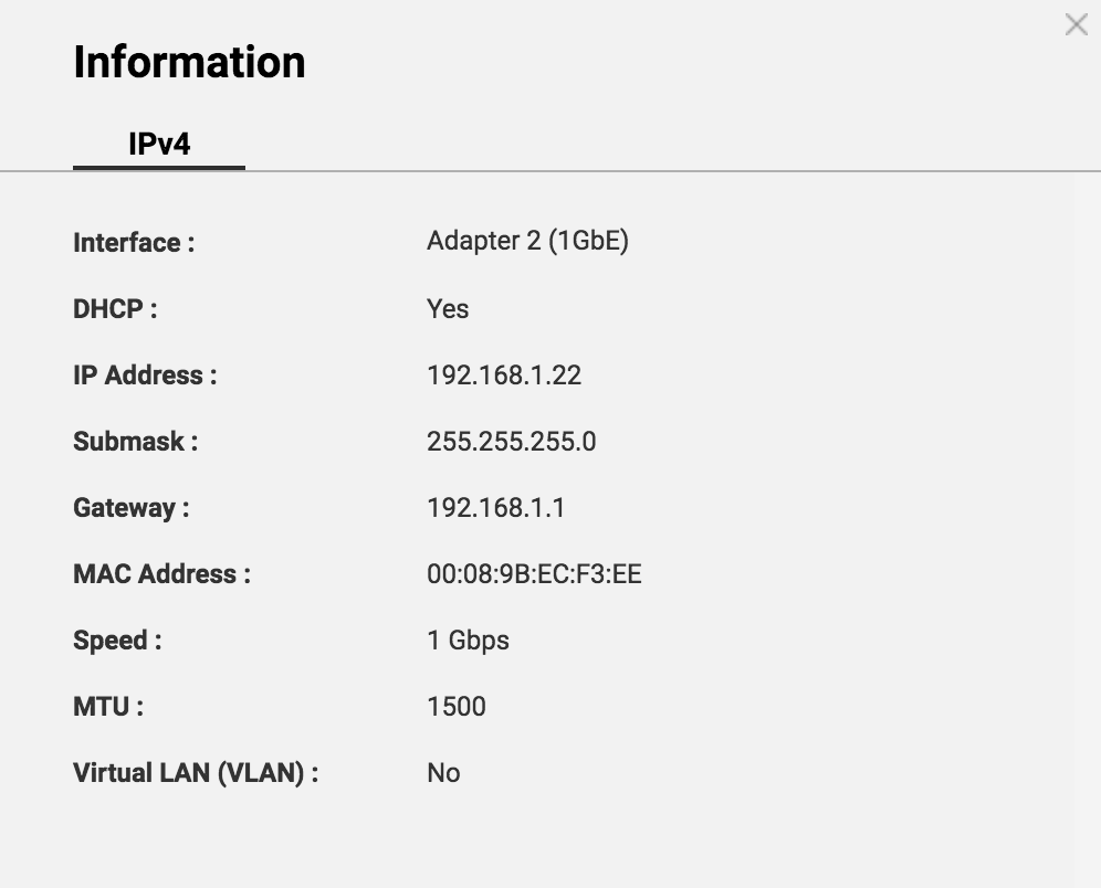

Thank you. I don’t have a TCP/IP or Wi-Fi or other options, I have this:
Do I need to activate the network & virtual switch?
I hate QNAP and their ā€œNew and fancyā€ versions :wink:
Click on the information icon to the right
Like this?
Here’s what’s behind the info icon for the connected adaptor;
And that answers your Q then regarding subnets…
You are in the same IP Net.
