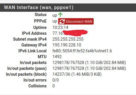

Here is a pfsense Firewall / NAT / Port Forward rule
It is the only modem/router in the loop. It receives from the ISP and creates my 192.168.0.x LAN as well as does the port forwarding from the internet.
Screenshot from 2025-09-27 19-05-56
It reads:
  1. Traffic arriving on the WAN adapter
  2. using TCP protocol
  3. From my “Allowed Remotes” group (a list of known IPs)
  4. From any port on their side
  5. Which is targeting my WAN address (the ISP assigned IP address)
  6. with destination port port 31417
  1. Is forwarded to 192.168.0.20 (the PMS server
  2. port 32400
When you fill out the form for this, it looks like:
The “Allowed Remotes” alias includes the Plex Sidekiq server IPs. This is how Plex is able to test if I’m “reachable” and my remote access works.

I tried with the combined modem/router from the ISP (draytek vigor thing)
and I tried with a DSL bridge that is connected directly into a LAN port of my QNAP. PFsense runs there, doing PPPoE with the ISP. Both don’t play nice.
I tried with 32400 and 32407, both look good. Also seen in logs. (it arrives at the server)

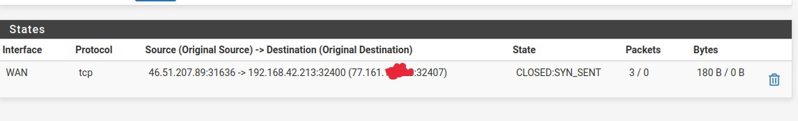

firewall session/state:
I do see this after a while.. IP .254 is the pfsense. relevant? or just session cleanup?

@blackpaw
  1. QuFirewall is not required. ( I am running on both 5.2.6 and 5.2.7 - two machines)
  2. Combining modem/routers creates Double NAT – which is alias for “CHAOS!” :smiling_face_with_horns:
  3. What’s the make/model of the ISP modem and can you log into it for Port Forwarding configurations ?
  4. Removing PfSense from the chain is advised (you have double NAT or multi-path with both involved)
