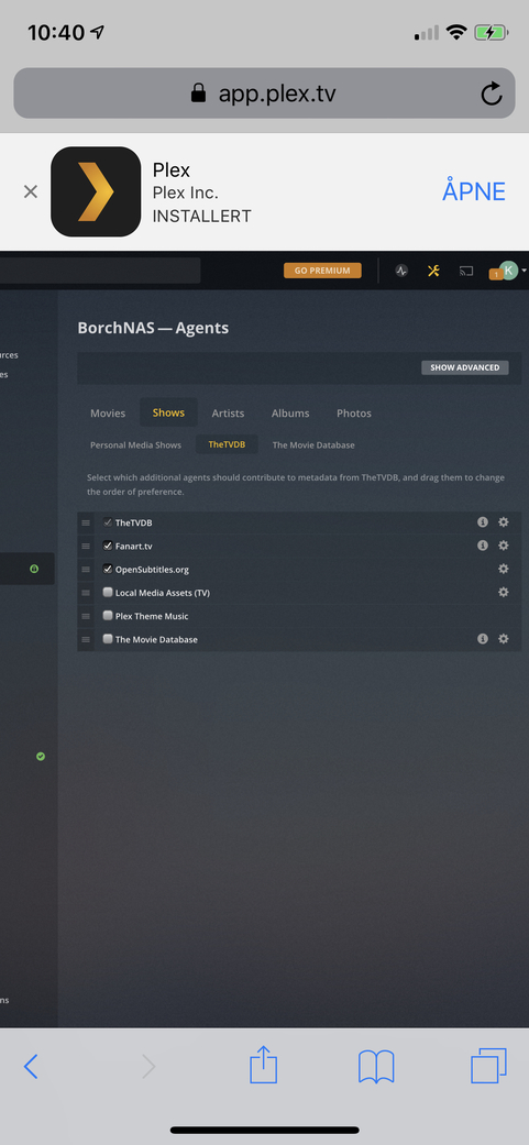

Can you show us a screenshot of your TV Show agent settings? And settings of the respective library.
I hope this was the correct screenshots you wanted.
Hm looks ok, are no series picked up at all?
How is the folder structure in the “Tv-series” fodler?
It’s the same settings I have always had and they worked before. When I tried re-adding the source, I can see all folders for each show and I can also see each file, but the scann just works for a short while and then stopps and nothing has happened. Is it possible to see something in logs? The same was for movies, but that worked again after I changed the scanner. The TV series on my server has a folder for each series.
I noticed a new update to the plex server today and after updating the scanning of TV series works again. Hurray!
