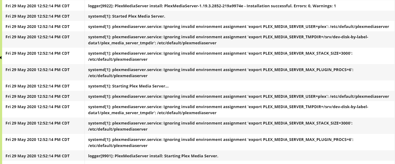

Just updated Plex to Version 1.19.3.2852 and it broke my fix. Rejecting systemd directive. This in syslog:
My assigned temp dir ignored:

Perhaps I misread the errors in syslog I reported earlier; they’re referencing /etc/default/plexmediaserver not systemd override. And yet I truly had reverted to using /tmp as I showed.
To sum up I have no idea what’s going on and need guidance as to exactly how to specify /tmp override. And what’s the purpose of /etc/default/plexmediaserver vs systemd override. OTOH it appears to be working the way I want. For now.
