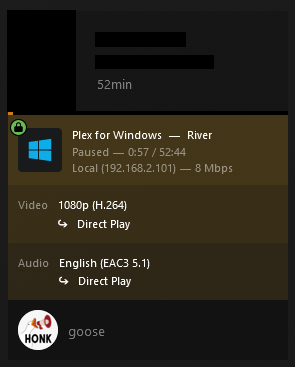

When is streams from server is it direct playing or transcoding?
Interestingly, I am now experiencing an issue where it will playback fine on my desktop client:
Screenshot 2023-08-30 210723
But no longer on my mobile device, with the error: An error occurred while attempting to play this video. Please check your connection and try again.

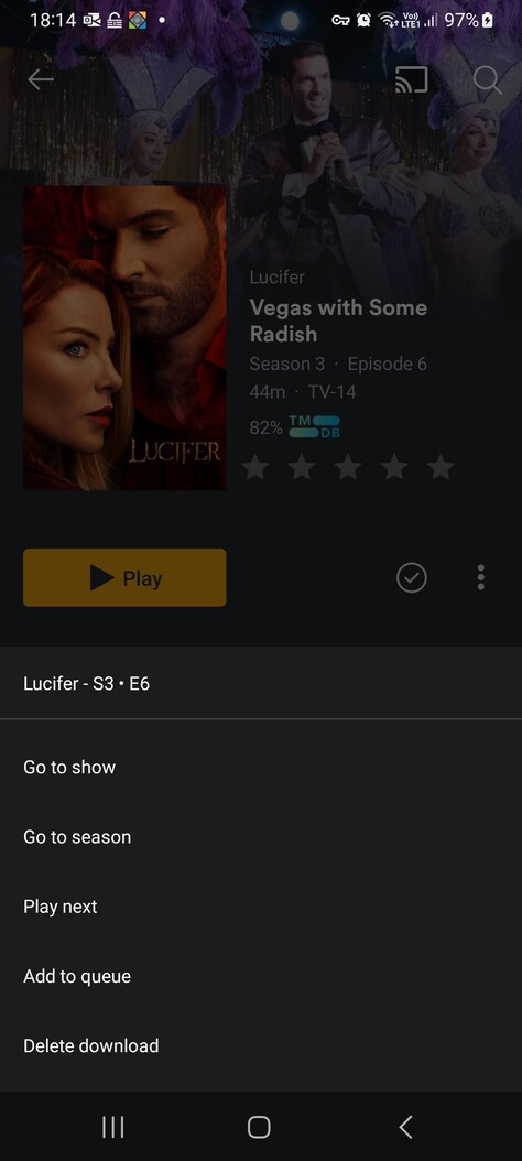

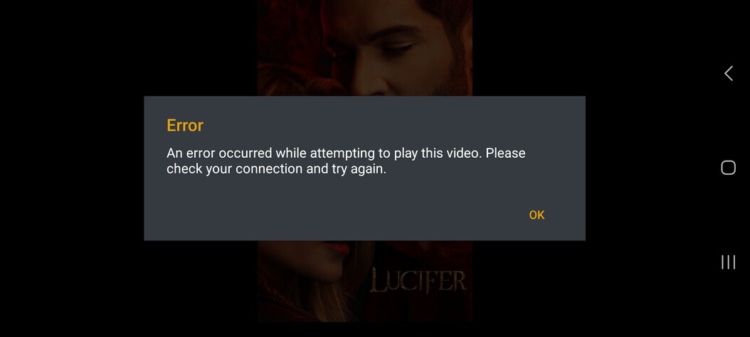

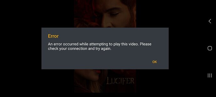

I’m having the same issue with downloaded TV episodes. Downloaded movies and music works fine. The idea of downloading episodes is exactly when you do not have the server available, Yet it complains about a connection and fails. This makes no sense.
I have a galaxy A3
When connected to the server it plays fine.
