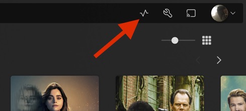

If a client requires a transcoded version of a file but the server cannot deliver the stream packages fast enough, clients can sometimes mix this up with the network not being fast enough / having sufficient bandwidth.
You can check the details on the now-playing card of the impacted stream on the server’s dashboard to see what’s happening.
I don’t see any indication that the clients require a transcoded version though. In fact, I just remembered that my Channels DVR server can play media files and have been streaming a high bitrate file for 45 minutes straight without a single buffer. I don’t have it transcode.
When you say to check what’s happening, what are you suggesting I look for?
I believe @tom80H is taking about Activity /Dashboard/ Advanced
