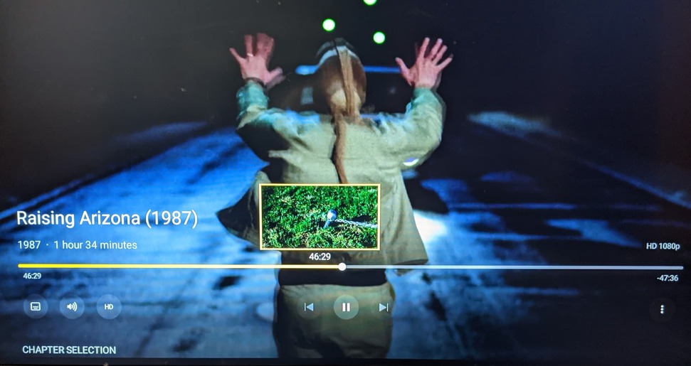

During playback, tap the top of the ring on the remote twice.
The first tap should bring up on-screen controls.
The second tap should move you up to the progress bar. You’ll see the white dot on the progress bar at the current location in the movie.
You can then use the left & right side of the ring to move through the movie at a faster rate than the default 10 sec back / 30 sec forward.

Holding the FF/REW buttons or the right/left side of the ring does move continuously, but only in increments of 30 sec / 10 sec.
Moving to the progress bar moves through the media faster.

I think the issue with the way that Plex does FFW/RW on Android is that if you hold the buttons to seek, I would expect the OSD to pop up so you can see the video thumbnails and see where you are fast-forwarding to. That is the way the Roku does it - even if you are only jumping in 30 second clicks - it immediately brings up the video thumbnails so you aren’t “flying blind.”. It is annoying that you have to go through extra steps (and then have a really small thumbnail on top of it all.)
That, mixed with the fact that if you hold the FFW/RW keys without bringing up the progress bar, the UI will continue to show the number of seconds you are skipping (I don’t know about you, but I have no idea what 4,050 seconds corresponds to, so I have no clue how far I am skipping ahead.)
