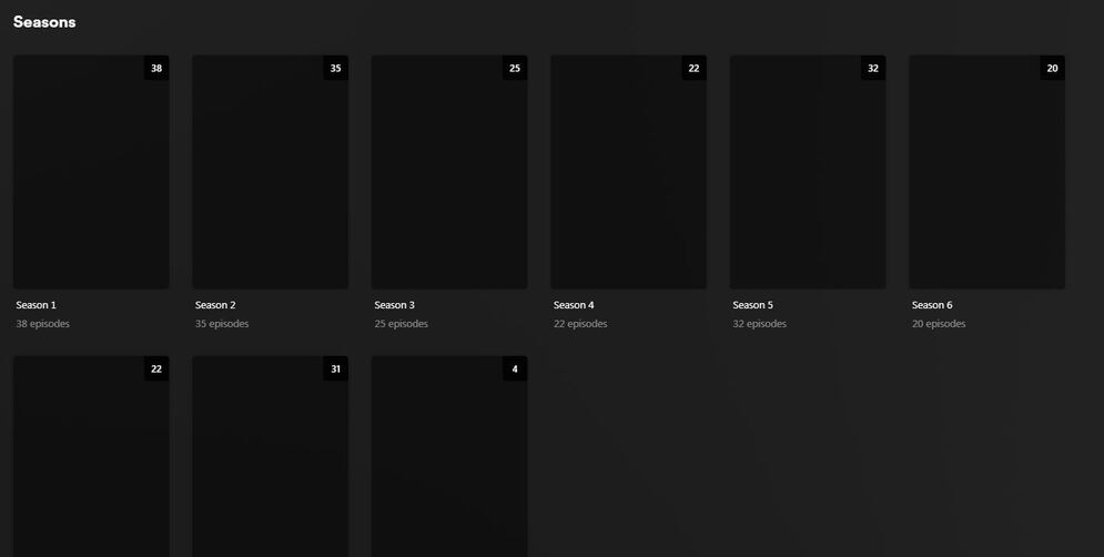

They all have the same prefix and then the a different suffix for the epsisode see below:
They are setup as a TV Show with Seasons and episodes. As you can see all the poster frames became the same. This was all working well in the past, I don’t know what went wrong. The file names are what I want plex to show
