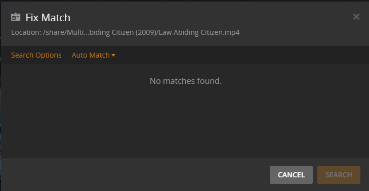

Fix match doesn't work
When I try to match a movie it doesnt find anything and when I try to do a fix match it says it cant no matches found.
what can i do to fix it?

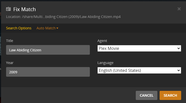

What ā€˜Search Options’ did you try? The capture you show is usually blank when you attempt to first open fix match. In the search options separate the title and the year and it should find what you are after.
Example:
Searching using the ID for the movie. So assuming it’s ā€˜Law Abiding Citizen (2009) — The Movie Database (TMDb)’ then search using tmdb-22803 and it’ll find the movie.
Using your settings above I select search and get the proper results. I take it you don’t get any?

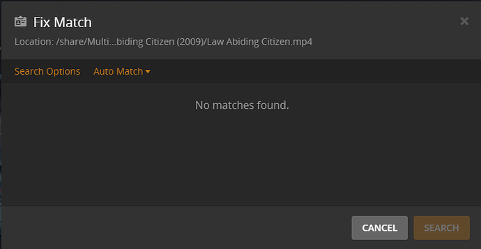

If i put ā€œtmdb-22803ā€ where the title needs to be it still says no matches found
even if i do it without the year.
Okay, I’m guessing something is then failing on your end, maybe DNS lookup or something else. Anything in your logs? Maybe upload the logs so the community can take a look.
