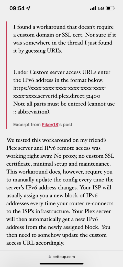

Just found this might try when when I get home what do you guys think?
Just keep in mind your ISP might still dynamically assign a different IPv6 address over time.
For the clients mentioned above this workaround should not be required.
