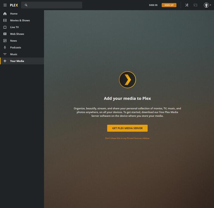

Next I changed the password for my account and signed out all devices. Now when I try to access my server directly, I get the web player but not the server itself, whether I’m logged in or not. Under the ‘Your Media’ page, it’s just a prompt to get plex media server.

Thanks. Yes, I’ve enabled 2fa and did try going accessing directly via :32400.
This is what I see:
edit: got it. needed to access it from the same host. thanks. any ideas about the intrusion? I would have imagined it shouldn’t be possible to remotely execute code regardless of login
Try it without the /web. Also try it with /manage/index.html# or /manage/index.html#!/setup
What happens if you click the login up top?
edit: thanks, got it. needed to access it from the same host. thanks. any ideas about the intrusion? I would have imagined it shouldn’t be possible to remotely execute code regardless of login
Yes same host. My bad, thought I noted that. The putty trick essentially makes the traffic appear from the same host as well.
