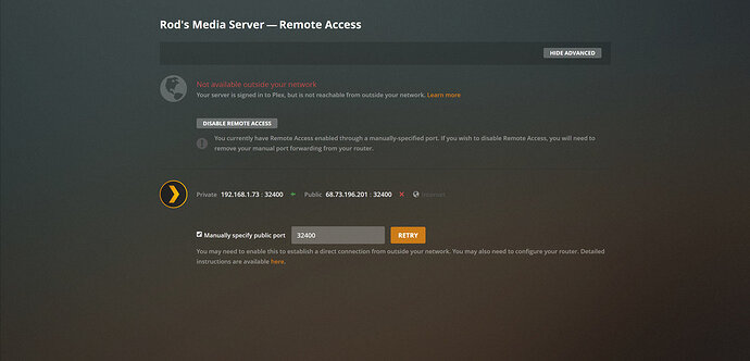

Having checked the above, go through Disable Remote Access, wait a few minutes and then Enable Remote Access and wait few minutes and then capture logs again and also router configuration screenshots showing if there is a port forward and if there is a DHCP reservation for the local IP Address plus remote access server setting screenshot showing if manual port specified or dynamic uPnP

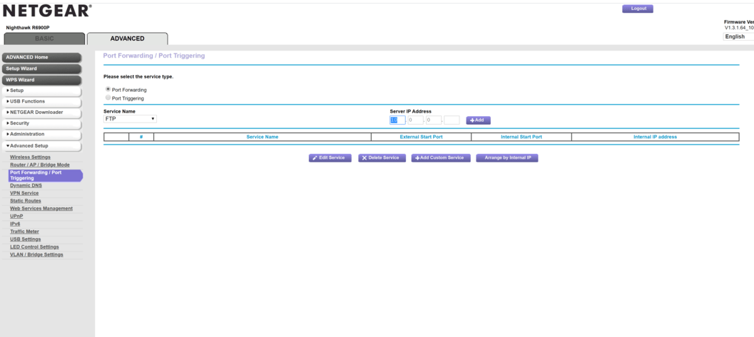

I don’t think I have port forwarding on. I’ve checked both the Netgear Router (R6900P)and the A&TT Fiber Modem/router (ARRIS BGW210-700) and cant see any port forwarding happening (screenshots attached)
The ‘Remote Access’ is a weird one… I have a constant ’ Not available outside your network’ message and when I try to enable remote access, it goes green for a second or two, and then goes back to the ’ Not available outside your network’ message. I’ve attached the logs as requested

Looks like a Double NAT situation - confirmed by these log entries
Feb 23, 2020 09:28:25.374 [0816] DEBUG - EventSource: Got event [data] '<Message address="68.73.xxx.xxx" port="21919" asyncIdentifier="47bc6f5c-5f90-41da-9b92-203e3ea53955" connectivity="0" command="notifyConnectivity"/>'
Feb 23, 2020 09:28:25.375 [0816] ERROR - MyPlex: mapping failed due to potential double NAT configuration
See https://support.plex.tv/articles/200931138-troubleshooting-remote-access/
When you have two routers, one must be in bridge / modem mode. Please check it. You wan ip address showing on one modem/router must be the same wan ip address showing in the 2nd router
