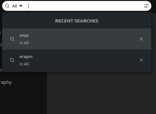

I’m also noticing that the Search field is no longer keeping up-to-date with recent searches.
These Recent Searches are weeks old, but the searches I’ve been doing today are not listed:
Edit: It seems that the search is added to history only if I select an item from the dropdown results. However, selecting “View all results” does not update the search history.

Search History will only show up after you’ve selected a result. So if you’re searching and just looking at results without selecting one, then that query will not show in the Search History (Recent Searches).
It seems non-intuitive that “View all results” should not do the same. A minor point, though.
