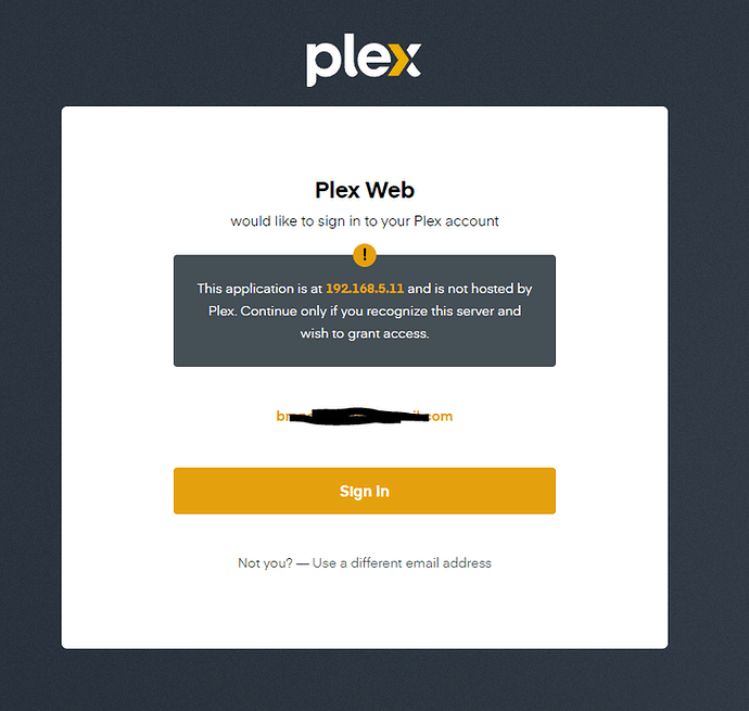

I need some help with this very same issue.
I cleared the attributes from the Prefrences.xml file.
When I browse locally I get the following
Browse from my computer … No Claim option
Browse from incognito window … No Claim option
Browse from a server on the same network as my plex server …No Claim option

Are you using the IP address of your server to load the web app?
Is your server running in a container or VM?
Those error messages in the log are irrelvant.
I am browsing to the http://ipaddress:32400/web
I can get there, it does pop up for me to login
It is running as a VM, has been for many years no problem
This is completely normal. Click on “Sign In”.
