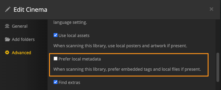

If your library is using the new Plex movie agent, rather than Plex Movie (legacy), then in the advanced settings of the library uncheck “Prefer Local Metadata”

From what I see I use that agent (don’t see legacy mentioned anywhere) but I can’t find this option neither than the other 2 in your screenshots
Then you are likely using a pre 1.20.x version of server
