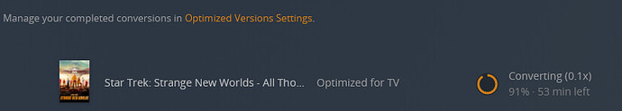

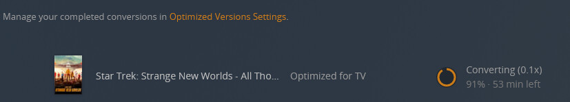

Could you please advise if this is the same issue as the one below (24 hours to transcode a 60 minute episode):
FYI – I needed to do this ā€˜optimisation’ because while this will work perfectly from the iOS Plex app on my iPhone (even when then cast to my Sony TV running Android), it wont work directly on the Android TV app on either the nVidia Shield or the Sony TV)
Not the same issue. It does appear to not use hardware transcoding for that optimization, but I can’t say why. I’ll need the logs from the start of that.
