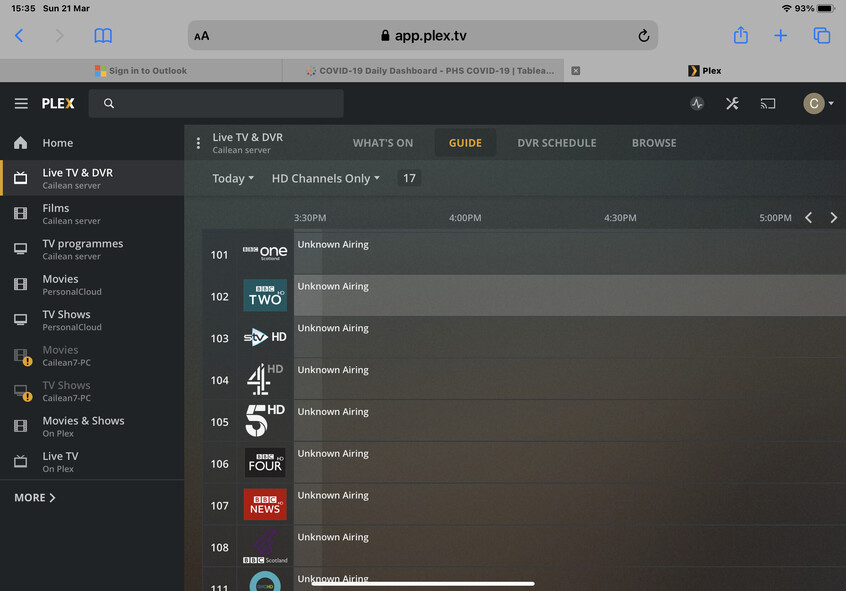

Yes I am having the same issue. Also when I select filter HD only in the guide some of the channels state “Unknown Airing” Unknown Airing

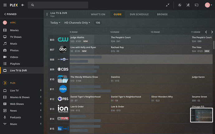

I see that the channel is defined as HD by the tuner:

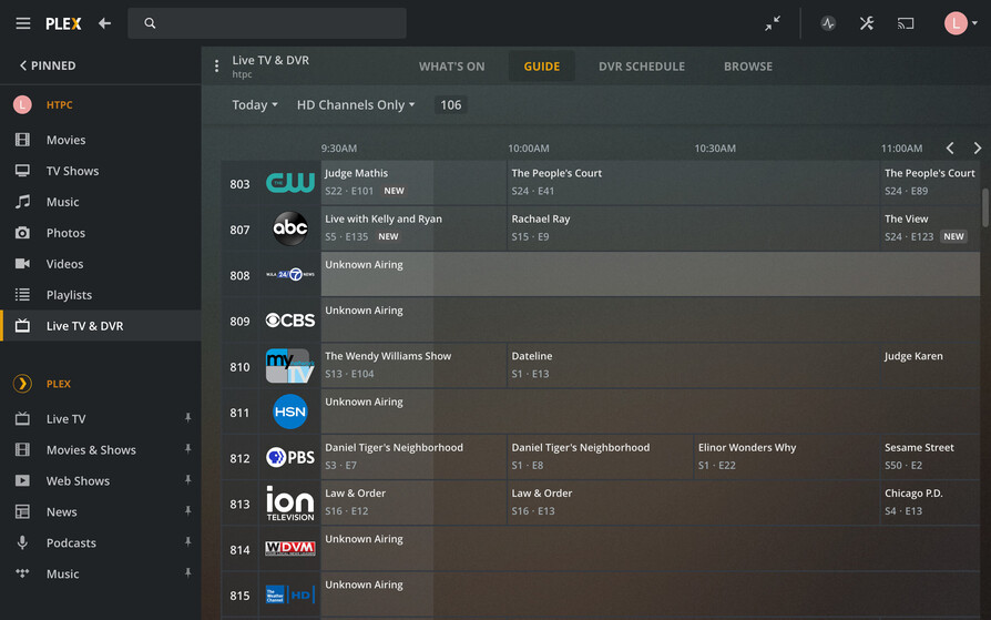

But selecting HD channels in the guide looks wrong:

When you look at the listings on HD Channels only they mostly show as Empty so would suggest it is an EPG issue.

I have the same problem. Started last week. If I set them to “Prefer HD” they will show on the schedule and show as recording SD. HD channels are showing “Unknown Airing”

I am also seeing this. I deleted and re-added my tuner. I tried filtering only HD and it only showed 1 channel. Then I rebooted Plex and am getting the exact same Unknown airing message for all but the one channel. I didnt have anything set to record last Friday so I’m assuming it started the same time as the rest of yours.

The filter on my EPG seems to be the culprit. Can see the HD channels in the normal view of all channels but if I filter to show HD channels they all say “unknown airing”

the filter is not at fault per se but it would appear that although the channels are in HD the guide listings are not showing the programmes as being in HD so its showing the channels with no content. That is why when you select ALL CHANNELS there is programming information in the HD channels but not when its restricted to HD ONLY
