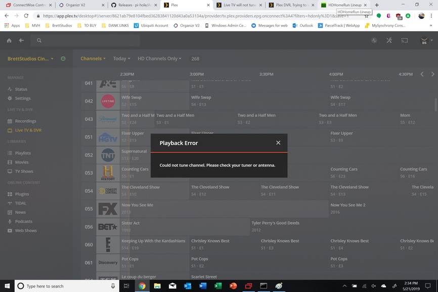

Suddenly, I have noticed that a good portion of my HD channels will not tune,

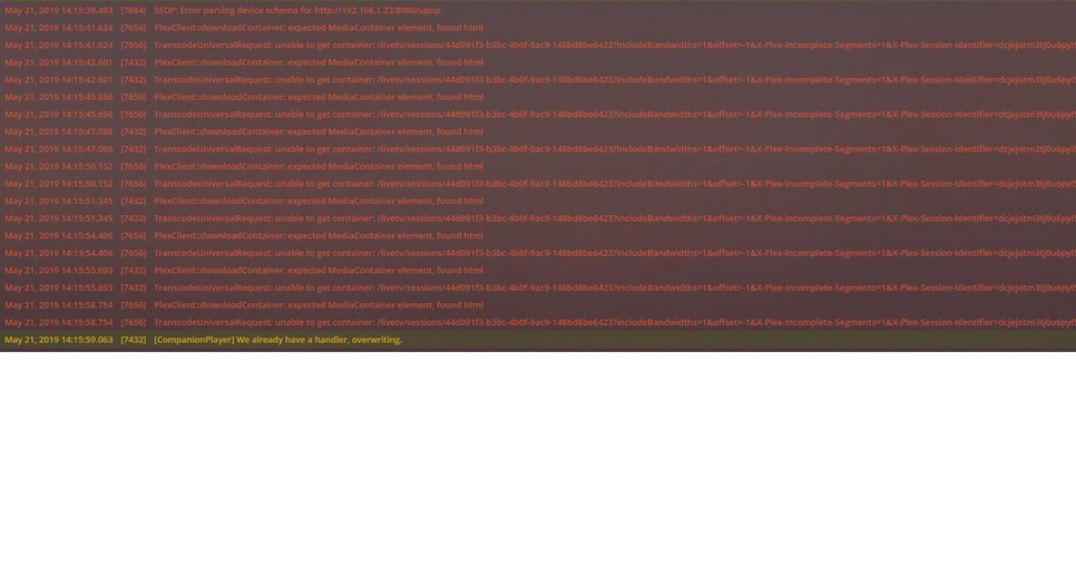

In the plex terminal log I keep seeing an error about transcodeuniversialrequest unable to get container.

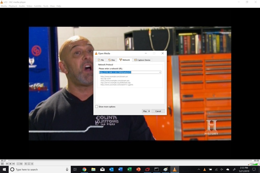

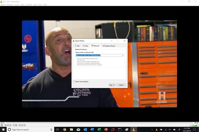

I manually grabbed the hdhomerunprime stream url and plugged it into vlc and the channel tunes and plays perfectly.
When trying to play the channel from plex it errors out. watching the hdhomerunprime tuner status I do not even see plex start/attempt a tune.
