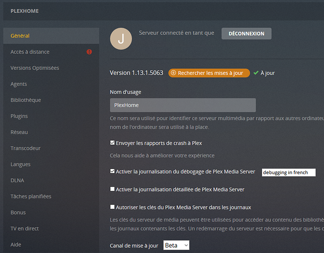

Here is also the details of my server. it shows that debug is enabled.
Thanks again
