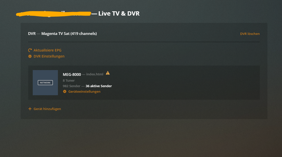

Situation before the first “faulty” channel scan (I always take screenshots of my Plex DVR setup since I made the experience that something, even if it is just the amount of activated channels gets mixed up during DVR setup):

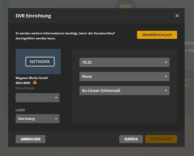

This is my scan setup:

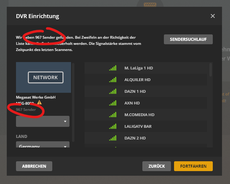

Plex shows 900+ channels during scan (please see also the attached tuner logs):

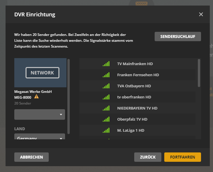

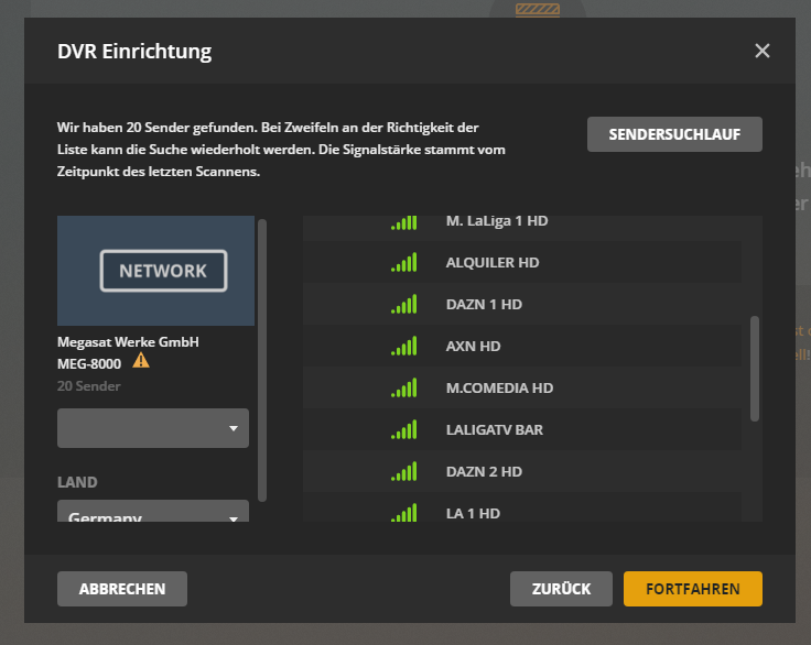

The scan result is poor as described:
These are the four first transponders of Astra 19.2 E of which the scan result list is made of:
