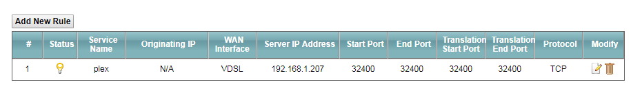

I googled that model and port forwarding and it showed shots similar to the one you posted but for port forwarding.
All you need is port 32400 and that IP you setup above to populate it, if you need post shots of the port forwarding and we can help populate it.

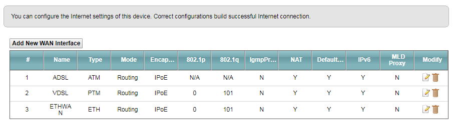

I found the section in the router about port forwarding. I still think i need a bit help filling in the fields
in the dropdown i can choose
  • WWAN
  • ADSL
  • VDLS
  • ETHWAN
  • default
iv tried to add 32400 and the static IP - it did not work
Do you use the VDSL for your WAN interface? ( I know seriously they make everything into acronyms )
All the rest looks right…

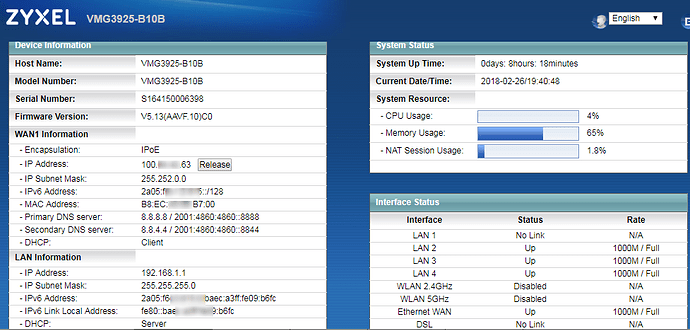

Can you get find the WAN IP of your Zyxel? and does that IP match what canyouseeme.org shows?
I have no clue about VDLS for my WAN interface :slight_smile: How do i check that?
I can see an IP on canyouseeme.org and it shows as a success when testing with the port 32400
but it does not match the one i have used in Zyxel. The one used in Zyxel is the internal one 192.168.x.x - the one canyouseeme.org sees is the “outside” IP
did I use the wrong IP then?
i dont know if this helps at all?
So your Zyxel should have 2 IPs.
1 - Internal or LAN with 192.168.x.x and in your case is probably 192.168.1.1
2 - External or WAN with hopefully a Public IP that starts with anything but 10.x.x.x, 192.168.x.x, 172.16.x.x or 100.x.x.x
so the IP on canyouseeme.org should match your WAN and looks like it starts with 82. can you find this WAN IP on yours?
Should look something similar to this, sorry about the A, B and C on the diagram I just took it form the zyxel site
i finally found that screen
(i have no clue if i needed to blur anything. Can this be misused?)
It looks like the IP from canyouseeme.org is not the one shown in that list. What does that mean?
So yeah based on that it looks like the 100. is probably a Carrier grade NAT which means you are in a double NAT situation.
