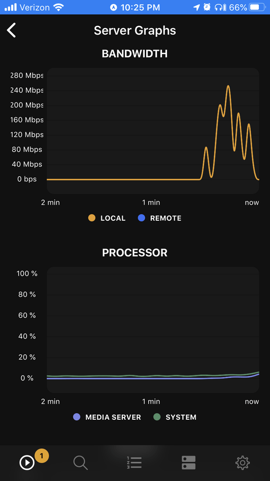

Help, Plex LAN traffic at 280Mbs
I have been trying to use Plex recently but can’t get any content to stream over LAN. I have tried on multiple clients, some wifi, some wired but every one of them Spikes to 280Mbs when I start a show, and stays between 200-300. The show then buffers and gives me an error about not enough bandwidth.

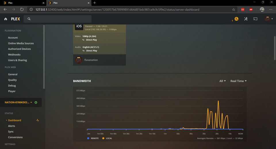

One more screenshot below from the server showing directplay at ~450Mbps.

I think the graph is wrong. Technically, it’s right, because PMS doesn’t know something wrong is going on. PMS is sending the file as-is in packets (pieces) to the client, that’s how file transfers work. But the client is failing to receive these packets in whole, but it doesn’t report to PMS where it failed so PMS thinks it sent the entire thing but in the wrong amount of time so the bandwidth numbers are just wrong. I’m not sure if this can be fixed, but I’ll bring it up with the team.
As for the actual playback problem. I am only looking at the example shown in your logs for your iOS device. It appears that the file is being forced to use direct play, but the file includes eia_608 closed captions. iOS doesn’t support direct playing this so it is failing.

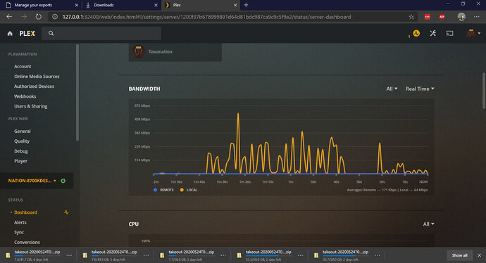

Okay I was being dumb with MKVtoolnixGUI, that seems to have helped significantly. Still setting an initial spike and 30-40Mbps spikes which seems high, but everything is running great, no buffering or anything. I still don’t understand why it is only via lan that I see this issue, but I’m not going to ignore what seems to be a solution. I’m off to remux all of my media :slight_smile:

That’s perfectly normal. At the beginning of playback, the client is filling its buffer memory as fast as it can.

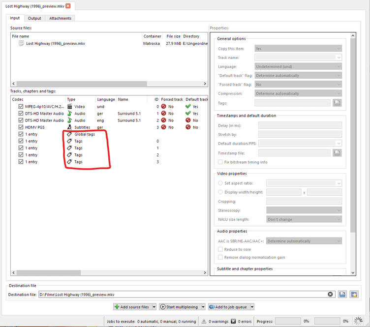

Since you’re remuxing anyway, you might want to disable all of these, if you encounter them.
Might as well take the opportunity to assign proper language tags to all audio and subtitle tracks (in case they are still on und)
