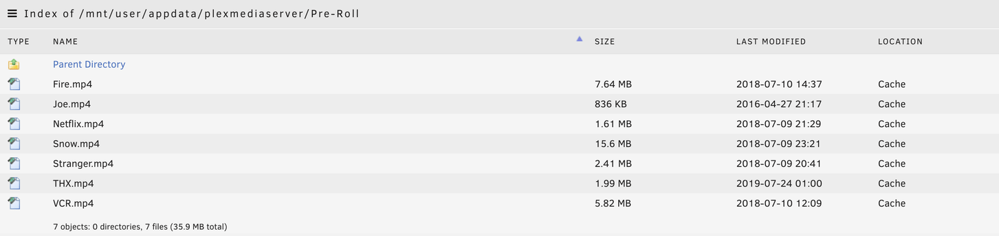

here is an actual example:/mnt/user/appdata/plexmediaserver/Pre-Roll/Joe.mp4
Here are a couple of screenshots to show you - as you will see the Joe file has been there for some time - i recently added in the other files (which i’ve gotten from other users on the forums) to test and see if something went wrong with the file but nope - none of them work)

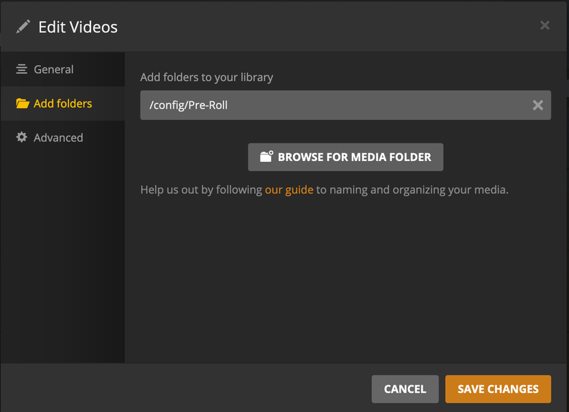

here are my docker settings and the library settings for my Videos library (not the same as my TV or my Films libraries)… tried seemingly every combination i can think of but if you told me i’ve done something very basic incorrectly i wouldn’t be shocked. My Videos library is not mapped on the docker level.

HTPC_Lover refers to the preroll videos for which you point Plex to /config/Pre-Roll (according to the screenshot above).
