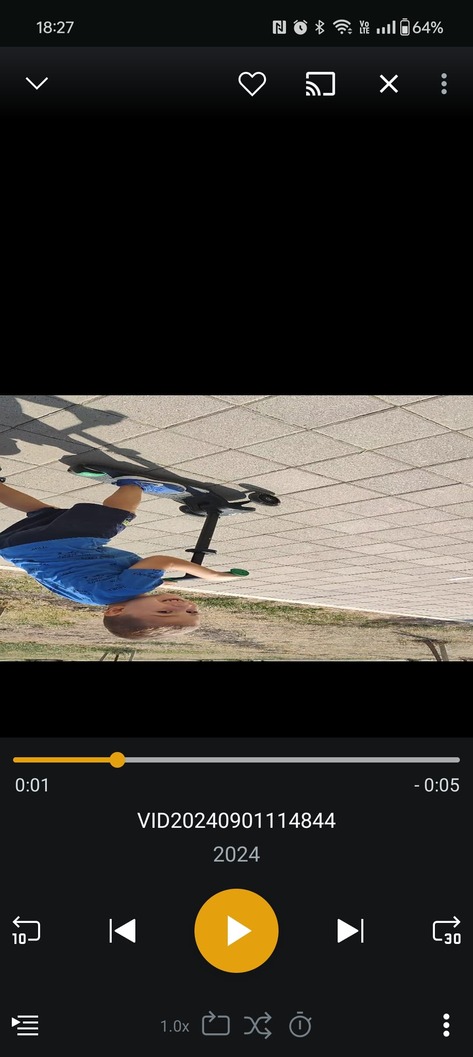

I have managed to isolate the issue on Plex Android apps.
When a video recorded on the phone is being played through Plex Web player, it is correctly orientated.
When played through any of the above-mentioned apps, this is the result:
If I turn on conversion, orientation changes but is still not correct:

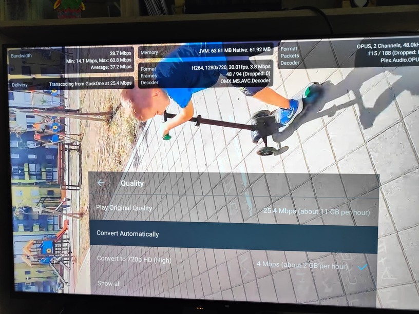

Here are the tests you have requested from Android TV plex app. Orientation is still off. I have tried to show as much details possible, hopefully it will help
720p
480p
Please note that the results are the same across all Plex Android apps.

With the Plex Android version 10.26.0.2578, the issue is still present however, if you turn on Conversion, orientation becomes correct but, the video gets stretched horizontally. The resulting video sits somewhere between uncanny valley and nightmare fuel. Please, see it for yourself.
