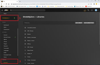

Pictured is my Manage → Libraries panel on my server. I have a bunch of libraries. In the upper right is an Add Library button. Click that, and follow the steps.
