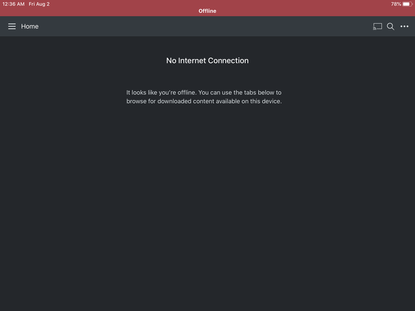

I worded it wrong how do I PLAY my synced content. Nothing shows up just says no internet connection.
Can you post a screen shot because what I described is exactly how you do play downloaded/sync’d content.
Also, was your plex app in offline mode when you installed the beta? Is so, a bug that the devs are already looking into.
https://forums.plex.tv/t/turning-offline-viewing-on-off/440628/3?u=darcilicious
Here is the problem your screen says “use the tabs below to see synced content” there are no tabs below and that is what I was trying to figure out.

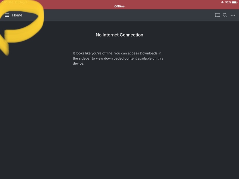

Added a on this device section to home screen
Turned on airplane mode and again nothing
Still broken

Unless you don’t see your sync’d content in the Download section per the message in the your second screenshot, then it is working as designed.
You now go to Downloads in the Sidebar Navigation to view your downloaded/sync’d content.

You supply a HOME screen, on that HOME screen you allow to place a ON THIS DEVICE section, correct? (pic below)
When offline why is that ON THIS DEVICE section that I added to my HOME screen not shown? Why am I getting a blank NO INTERNET screen instead of showing my libraries offline and my ON THIS DEVICE showing? Like this which happens sometimes
How is the HOME SCREEN supposed to work? Like above (which is they way it SHOULD work) or just show me nothing? (like below)
Because more often than not I get the blank screen. Once I setup my HOME screen I should almost never have to leave it and go into those DOWNLOAD sections.
