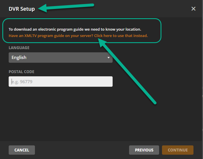

Could someone please advise how we go about changing the EPG that Plex is using? For the life of me I thought it was as simple as going to SettingsLive TV & DVRDVR Settings but it no longer seems to appear? In step 6 of this article it suggests you can choose during setup but when I removed and added my HD HomeRun it simply shows me a list of channels.

Question 1: You must delete the DVR, not the device from the DVR. The option listed in step 2, not step 6, is only available when creating the DVR.
