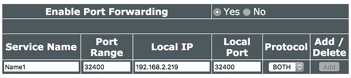

I have plex working on the local network no problem - however remote access is not working :
Private 192.168.2.219 : 32400 Public : 32400 Internet
  • I have port forward set up on the router to port 32400 but it is not working - can someone help me out?
i tried clicking setting up manual port and that still does not work…
your port forward looks like this ? if you go to canyouseeme.org and enter 32400 as port does it say it is open?

If you cannot put he Verizon in bridge mode then.
Look in your Asus take note of the WAN IP which you will find like in the image below. In the Verizon You need to forward to this address.
In the Asus you need to forward to the IP address of the computer that has the Plex Media Server installed.
Just use 32400 for all the port entries.
yes this worked !! finally ! thank you!! however, i deleted the plex app from my iphone and reinstalled it, and i login and nothing is coming up in there. it says “connecting to mycloudex2ultra” and just keeps trying to connect. this is from OUTSIDE the network. On the network, it works normal.
