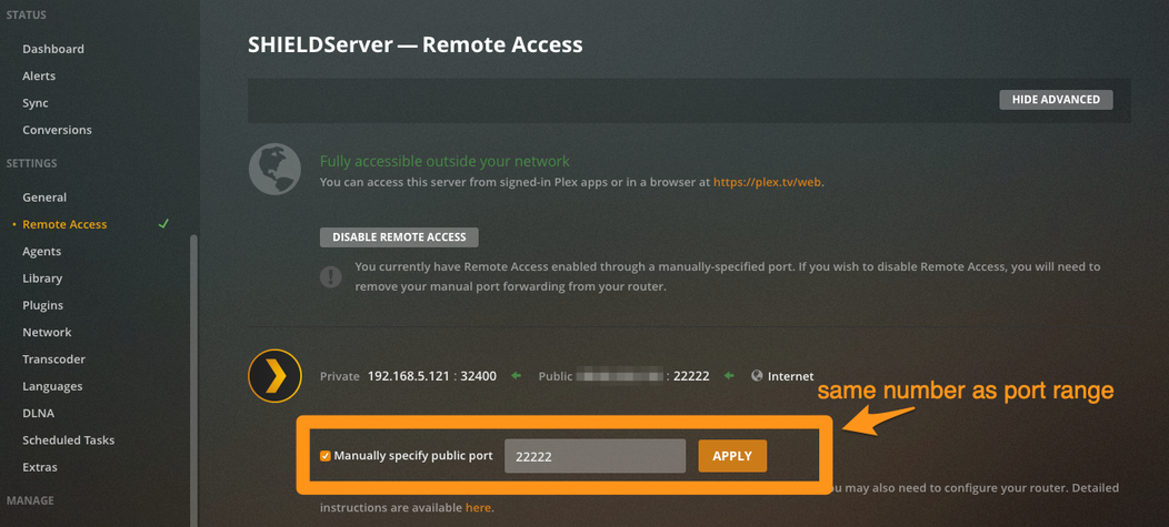

In the Plex Remote access settings
  1. Hit Enable Remote Access
  2. In the Manually Specify Port field enter the same number you used in step 3c above for the Port Range in your router. In the image example I used 22222
  3. Hit apply. (might have too hit Enable Remote Access again) Done
