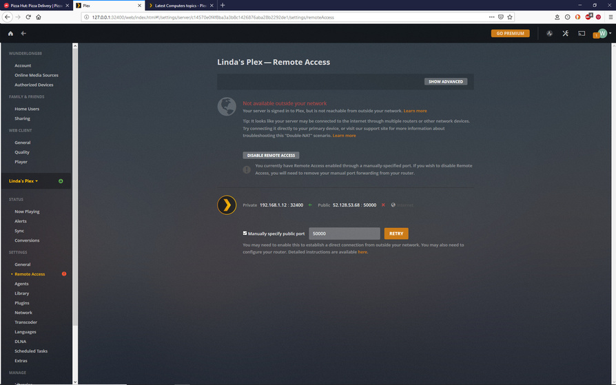

This is way over my head but I’m including a screen shot of what Plex tells me when I try to enable Remote Access.
My server is on my pc running windows 10.

External start is 50000 based on your screenshot
External end is also 50000
Internal start is 32400
Internal end is 32400
Internal IP is 192.168.1.12
If it asks for TCP or UDP select both.

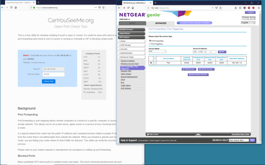

One setup test on canyouseeme.org and make sure it shows success for port 50000
Ok…I followed your instructions.
What do I put in canyouseeme.org?
I should say what ip do I put
So, if I did it right (I think I did), it didn’t work. What now?

Yeah that looks right…

So your Netgear has that public IP on it?
Idk exactly what I need to look for on the Netgear?
Try this…
https://kb.netgear.com/24223/How-do-I-check-the-Internet-connection-status-on-my-Nighthawk-router
Should show your WAN or internet IP which should match the IP you have above.
No, it does not match.
Welp I guess this made a liar out of me…
You are in a CGNAT situation based on that IP on your device.
Your only option is to pay for a static IP from your ISP
