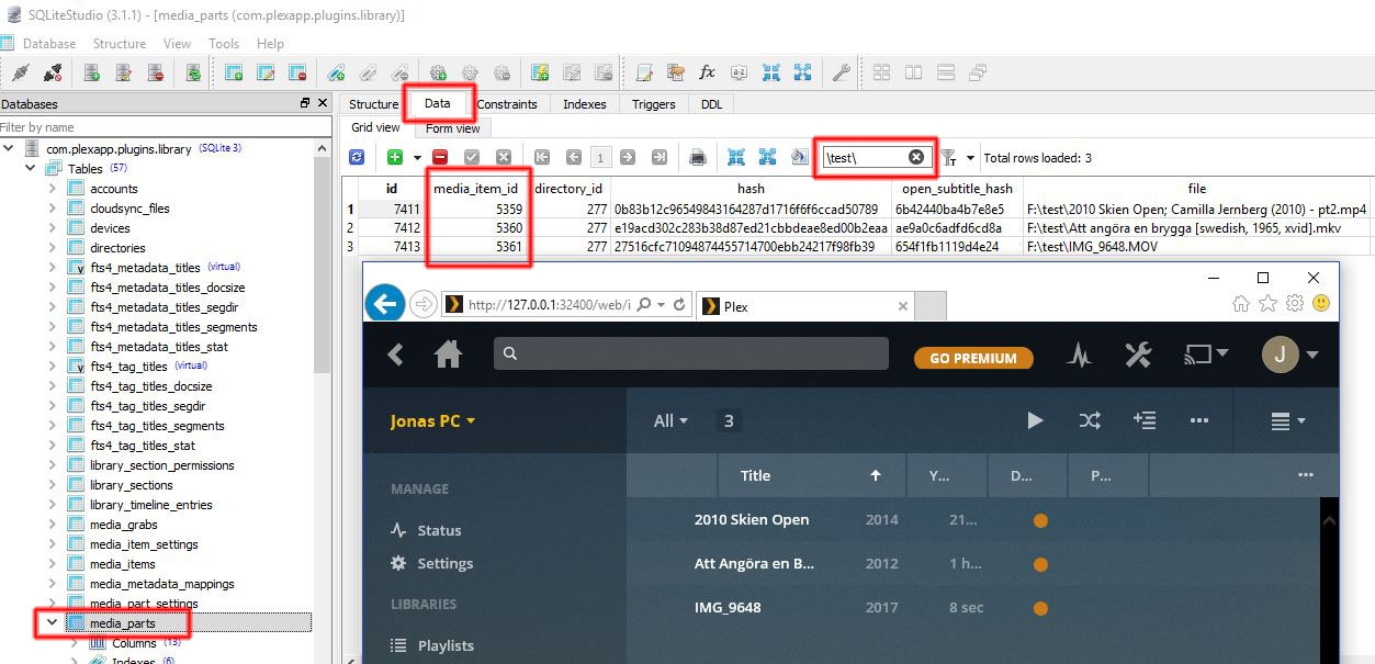

The database used by Plex is SQLite. I downloaded SQLite Studio from:
sqlitestudio.pl
and opened my Plex database %LOCALAPPDATA%\Plex Media Server\Plug-in Support\Databases\com.plexapp.plugins.library.db
  1. Expand the table media_parts
  2. Click the Data tab
  3. Filter the data you want, I for example entered “discgolf” in the filter text box since all files I wanted to stack are located in this directory.
  4. Locate the rows you want to stack. If the file name is to long to show in the file column, double click the file name on the row to expand it.
  5. Locate the row with the first part in your movie and note the value in the second column (media_item_id).
  6. Update all other parts to the same value of media_item_id
  7. Commit the changes when done.
This made stacking work for me. The column media_item_id does not seem to be a key in any other table and I have not seen any negative/corrupt consequences so far, but of course directly manipulation the database could turn out to have undesired effects later on, but it seems to work for now. I can stack whatever I want B)
You can always backup the database to be safe (it’s only one file).
—can be removed—

Evalutation / Proof of Concept
I changed four cases in the database where I manually stacked the files and they’re all playing fine.
I’ve edited metadata in Plex Media Server afterwards for these (ie changed dates, directors, description, tex) and the stacking is unaffected so from my point of view this now works very well.
Here’s an example to demonstrate:
I added three completely different files in a directory named test, these files were:
2010 Skien Open; Camilla Jernberg (2010) - pt2.mp4 (clip from sports event)
Att angöra en brygga [swedish, 1965, xvid].mkv (old Swedish movie)
IMG_9648.MOV (clip from my phone)
Then I created the Plex library forums.plex.tv with the following properties:
  • Library type: Other Videos
  • Folder: F: est
  • Scanner: Plex Video Files Scanner
  • Agent: Personal Media
Before any changes
After editing the column media_item_id (setting the same value for all three files)
All playing beautifully stacked in sequence in Plex, no naming conventions were required.
I have now used this solution for 1½ years and it works like a charm, no problems encountered at all.
