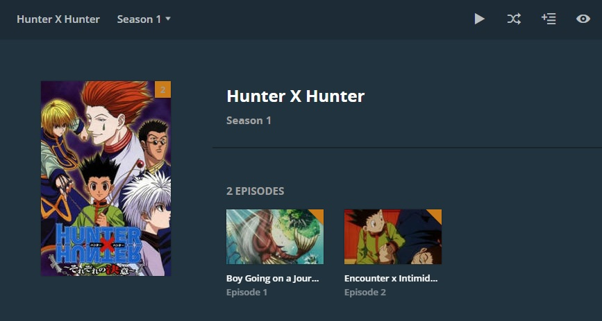

…Hunter X Hunter - S01E02.xxx
Results in Instant, fully populated match:
