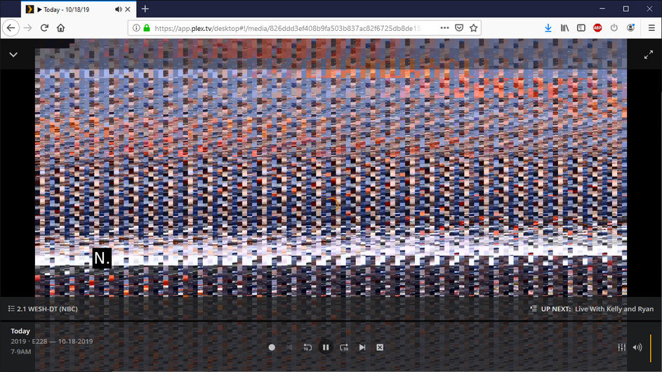

As an FYI, Live TV suffers from this same issue on the 918+ for both .1966 & .1973. The entire view shows artifacts. I had mentioned it here. I suspect it has to do with the updated drivers used for transcoding.
I did not have these artifacts in .1944.
Wow, a little salty this morning @trumpy81!
I was just adding that in versions 1.18.1.1973 & 1.18.1.1966 show similar artifacts with Live TV and subtitles. Yes, I did ā€œbotherā€ to check the screenshot which is why I brought it up - please see the attached screenshot:

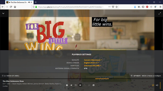

Now, subtitles off:
In 1.18.0.1944 Live TV would buffer every 30 seconds or so with subtitles on, but at least you’d see a picture whereas 1.18.1.1966/1973 show the artifact view until you disable subtitles on Live TV. Since the 1.18.1 line of Plex uses a new driver (at least for the intel iGPU from what I’ve read), I suspect it has to do with that.

Your supplied image show complete image breakdown which I attribute to the main codec breaking down .
We need to recreate a controlled test case with and without subtitles

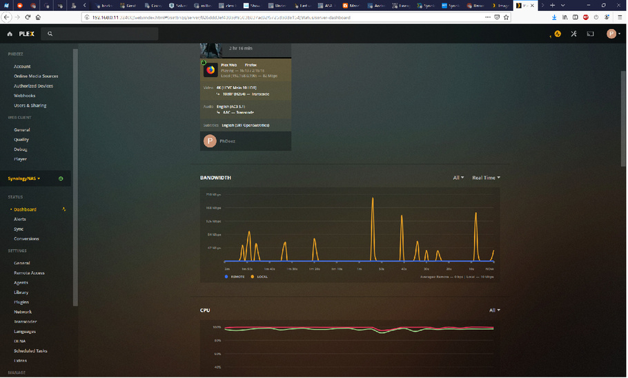

FYI, CPU utilization with hardware transcoding was in the 20-30 10-15% range for Plex.

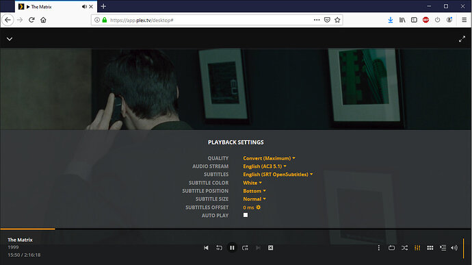

Just for fun I tried a 4K encode of the Matrix… it didn’t go well :rofl:
Honestly, I can’t tell you what I did to get them to work… I’ve seen threads here in the Synology forum saying they didn’t report, and even more reports on current versions saying they didn’t work and I didn’t know why. I believe ever since I’ve setup the DS918+ both CPU and RAM have reported on the Plex dashboard.
