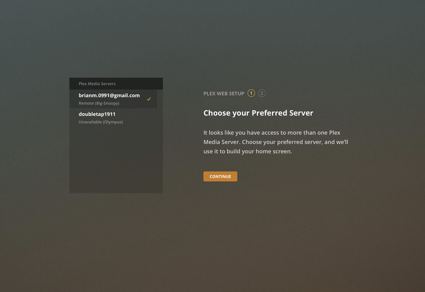

I restarted Plex on his server, gave it several minutes then typed in https://10.0.0.231:32400/web (which is his server). It asked me to log in so I did so with his Plex Pass credentials. After logging it it came up with this screen.
Oddly, it didn’t give me a choice of choosing his Plex Server (prehistoric).
After doing all of that I’m still getting the same issue. He doesn’t have any of the server setting options.
