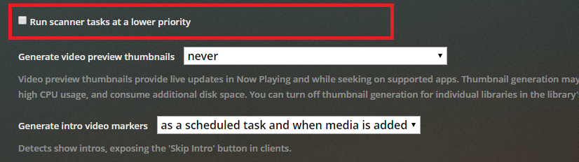

Do you possibly have this setting enabled?
I did. Just turned it off and restarted the server. It still seems to be struggling, restarted the same job and it’s been stuck in the same spot for an hour :disappointed:.
