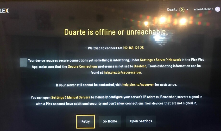

Description of issue: When I open the app it show a screen (attached below) with security request, I followed all the instructions but without success.
The same PMS Server is working on another Samsung TV.
Yesterday I updated the LG Plex Client App (it showed me an alert to update the version) and and after that it didn’t work anymore. Before updating for a few days the app showed me the same alert screen but after changing the settings it returned to work (but it showed me the alert at every starting of the app).

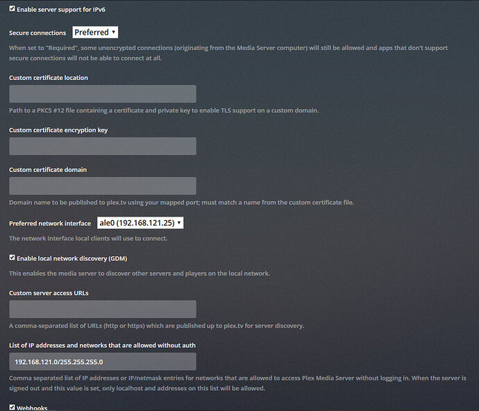

I’ve checked all the security settings on “Principale > Permetti fallback per connessioni non sicure” and also added the server IP on “Server manuali” section.
I’ve changed the security settings on “LAN” (“Rete” in italian language) sections of the PMS Server (“Connessioni sicure” equals to all the values; “Elenco di indirizzi IP e reti a cui è consentito l’accesso senza autorizzazione” is empty)

Problem:
The App reports the Plex server is offline or unreachable.
Your device requires secure connections yet something is interfering…

The Plex server is configured with secure connections = Preferred.

Thanks for all the information. I believe I’ve tracked the issue down to a deployment/configuration issue and have a couple fixes.
I’ve deployed a fix in 3.13.29 (this is a server-side update that will not require an update to the app on your device), which should automatically show up once the app is relaunched after the various caches expire, which should be soon. If you’re not seeing 3.13.29 in the next while you could try removing and reinstalling the Plex app on your TV to try and force it to get the latest version of the web app.
Please let me know if you continue to have issues once the web app has been updated to 3.13.29 (as shown in Settings: About).
