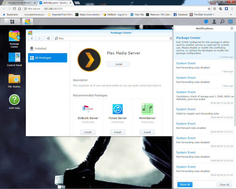

Ok so First thing was my Nas firmware update caused havoc with Plex…would not show a server…then when i finally get it to show I need to"claim server" and never got it claim…so with restarting the whole network and tried to claim still no bloody luck… Removed Plex and then I try and reinstall it i get the following message
Mind you that was both using the Package centre and a manual install…I am tearing my hair out…

As you can see this is a screen dump from my DSM and the plex Presences.xml
I have even upload a copy of the file in the following Zip so you can verify as well
