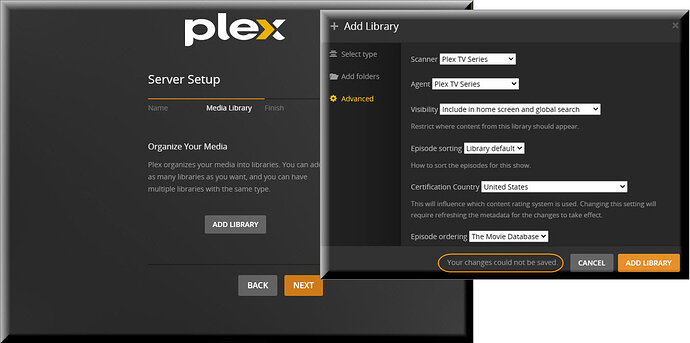

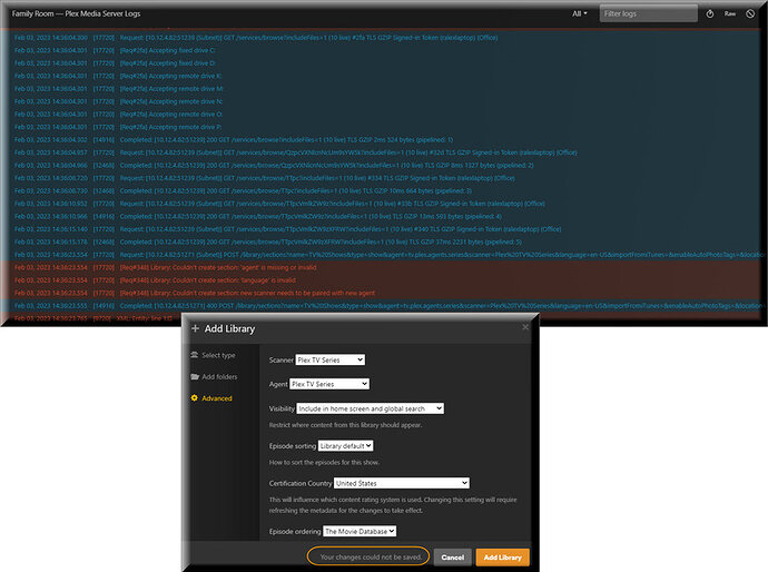

Language is Invalid and Changes Could not be Saved

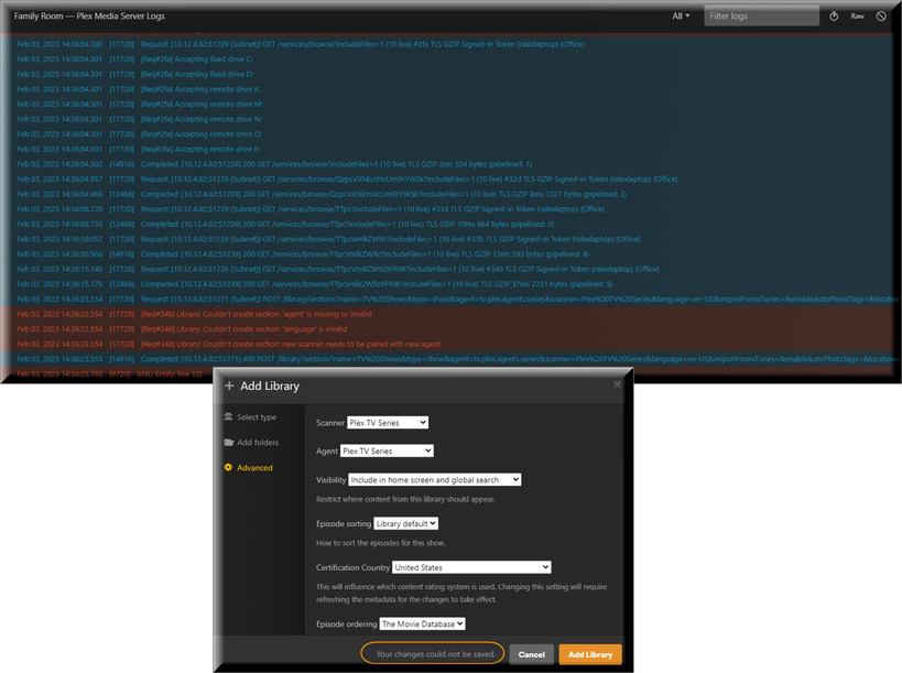

It turns out that just deleting the “…\AppData\Local\Plex Media Server” folder is not enough because after uninstalling the PMS, deleting the folder, and reinstalling the PMS, I’m still having the exact same problem. I still can not add my “TV Show” folder.

Just when I thought I was getting a fresh start, I still could not save anything.

I reinstalled a second time but I’m still unable to add and save a library.

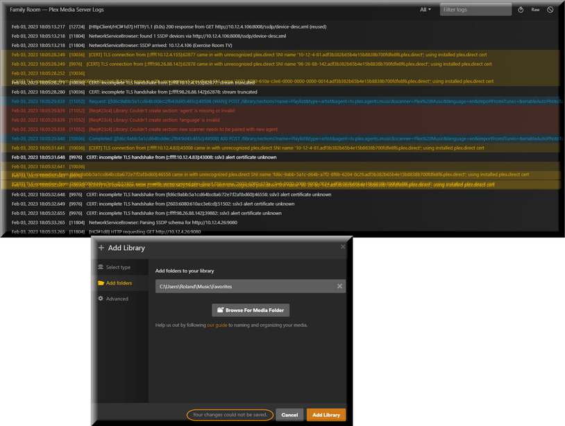

I tried to make it as simple as I possibly could. I tried adding a Music library from my local hard drive and I’m still unable to save that library.

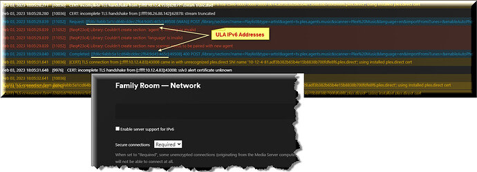

Something new. After this third install attempt, I’m now seeing a lot of certificate errors in my log. I’m not seeing these errors on any of my other PMS.
When looking closely at my logs while trying to add a simple Music library on my local hard drive, I noticed the use of ULA IPv6 Addresses and since I’m not sure how well the PMS application can support ULA addresses, I decided to turn IPv6 support off and reboot the PC.
It seems like turning off IPv6 support did the trick because I can now add libraries again.

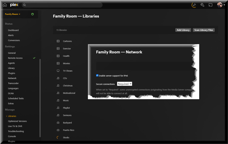

Just Some Follow-Up: I’ve re-enabled IPv6 and I’m still able to add new libraries.
Just Another Note: I have not rebooted the PC since enabling IPv6 again. I’m taking my time in adding my libraries back because according to the logs this PMS is now working overtime.
I monitored the logs while adding a new library and even though I’ve enabled IPv6 again all the log activity I see now is happening over IPv4.

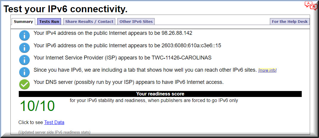

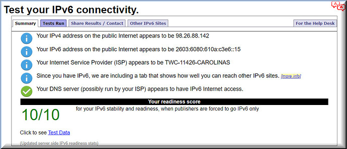

I fought the IPv6 battle with my ISP ten years ago. It just so happens that IPv6 is my primary responsibility. I have to get the Environmental Protection Agency (EPA) internal network IPv6-Only (without IPv4) functional in three years.
So my network does fully support IPv6
