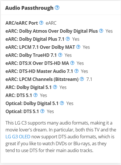

Before buying a TV, see if a review is available at rtings.com. They test audio passthrough for HDMI attached devices. Search the review for “Audio Passthrough.” FYI, unfortunately, some reviews are behind a paywall.
The LG C3 supports passthrough for Dolby Digital, Dolby TrueHD, and DTS audio (all variants).
From rtings.com:
LG C3
