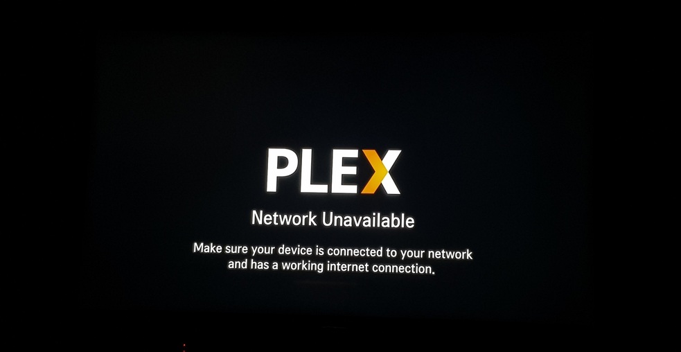

LG webOS TV app claim the server is offline
Server Version#: 4.47.3 up to date
Player Version#: 2.2.0 up to date (Plex app for Smart TVs - from LG CONTENT STORE last update for the app from Plex is on 17/03/2020)
LG webOS TV UJ620V (Software Version 05.80.65 up to date) player working flawlessly until maybe 1-3 weeks.
Now displays a message >

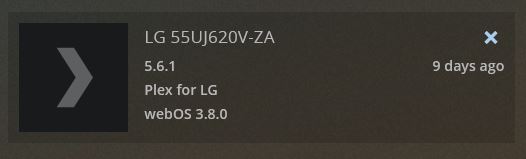

Please go to your Server settings /Authorised devices and forward the correct WebOS Client Version and your Plex Media Server version.
Do you have access to your LG WebOS settings?
Plex Media Server version 1234
WebOS Client Version - 3.8.0-61315
That looks like the WebOS version, not the Plex app version.

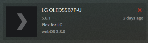

Authorized Devices is at https://app.plex.tv/desktop#!/settings/devices/other.
You should see something like:
Screenshot (403)
The current version of the LG Plex app is 5.6.1, released on Nov 24. You should have it, since you removed & re-installed, but always nice to confirm.

Do have access to the Plex TV app settings?
I have zero access to the Plex TV app, when I start the app it shows that

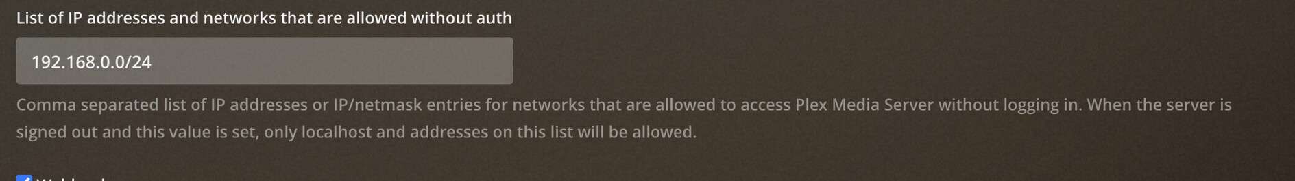

OK, just checked if you Tv is a UHD model, all Good there( HD models are no longer supported). Go to you Plex Server Network settings
Enter Your Router LAN IP address/24, like the one I have attached. Save and restart your Router,TV, computer.
In your Router- Reserve / make static your Server LAN IP address. This should stop any network confusion.
In your Server Network settings you must have Secure connections - Preferred ( Nothing Else)

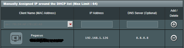

Find your computer IP address from there and make it static
I’ve an ASUS RT-AC68U. If yours is similar, the settings are in LAN -> DHCP Server.
Select your Plex Server from the “Client Name (MAC Address)” dropdown list. It should add the current IP Address automatically. You can add a DNS server if desired. Then click on the Apply button.

Edit: You can assign a static IP address via the app.
  1. Settings -> LAN -> IP Binding -> IP Binding List
  2. Tap on + in the upper right corner.
  3. Choose Select by Device List
  4. Find your server in the device list. Tap on it.
  5. You’ll see a “IP Binding” window with the current IP address of your server. Tap on OK in the bottom of the window.
  6. You should now see your server listed in the IP Binding List.
