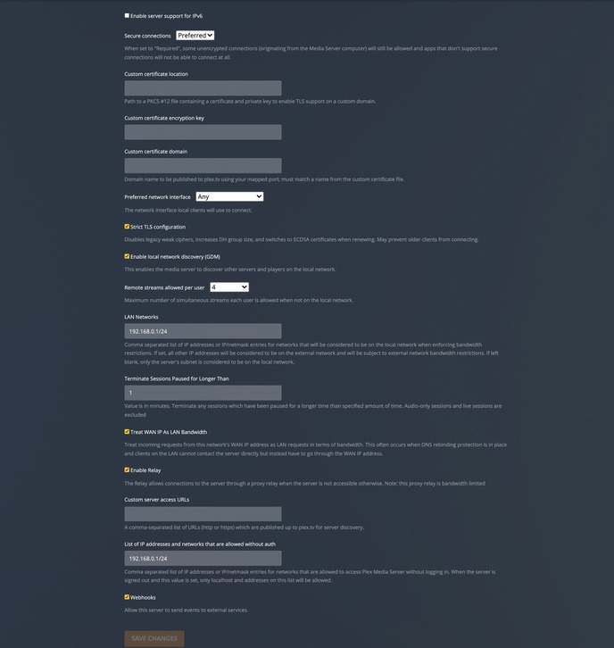

Well that seems dumb. Either way, I did as suggest and turned on allowed for insecure connections always but I’m still unable to connect. I hate the way a tv I bought in 2019 is classed as old.
Dumb or not is irrelevant, what is important here is having a connection. I have a 2018 model LG OLED without any issue, check your Server connections are similar. ( Router LAN address may differ)
Thanks man, I tried this but still the same :frowning:
