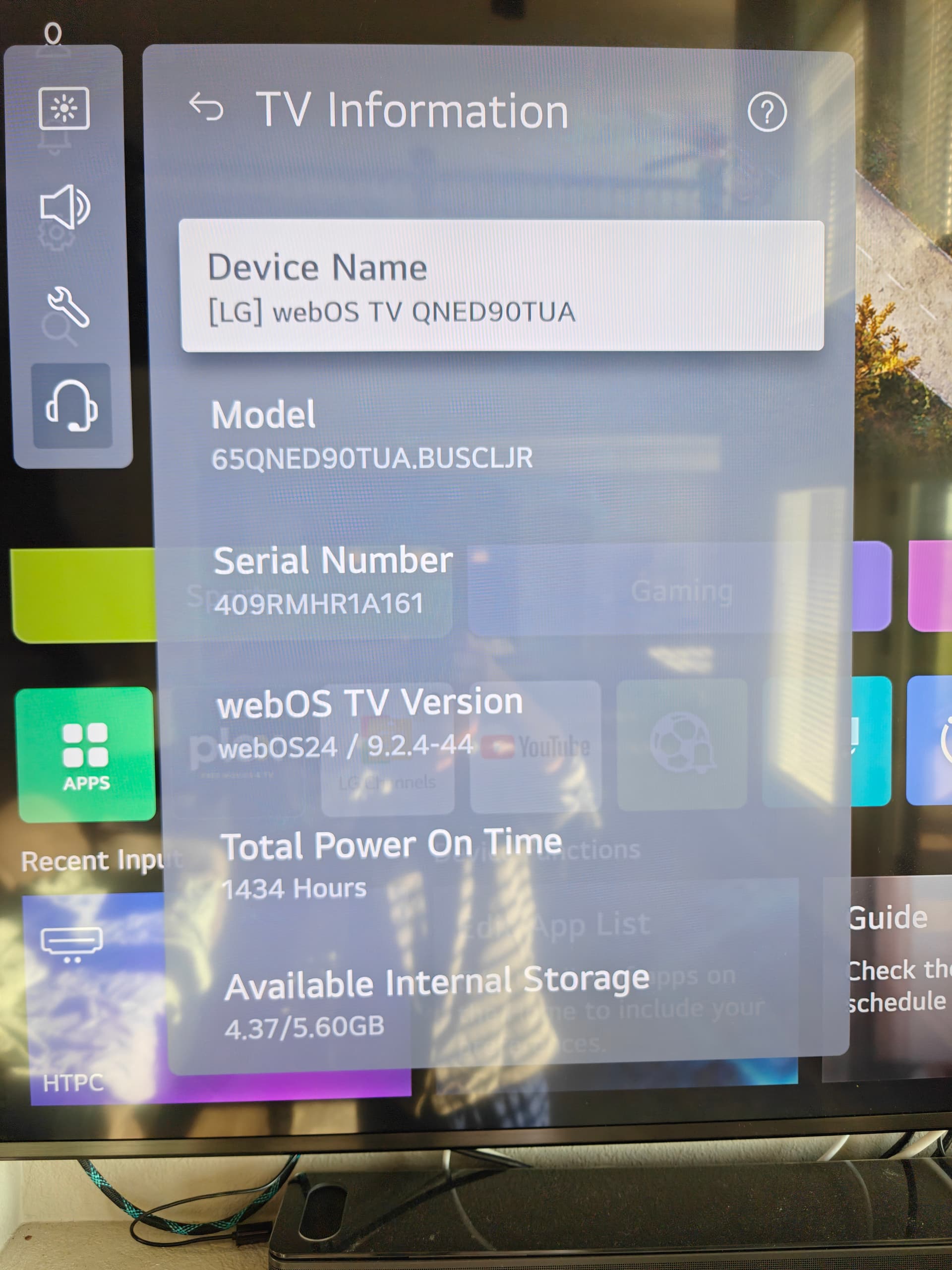

I have a QNED90 that is almost unwatchable with the built-in Plex app. The problem isn’t playback - that works fine. The problem is scrolling through libraries. It starts out fine but after two or three screens, gets slower and slower until it locks up completely. This doesn’t affect just the Plex app. The TV doesn’t respond to any remote buttons (Home. Off, etc.). Eventually I have to unplug the TV to get it to restart. Will see if I can capture anything in the log file.
