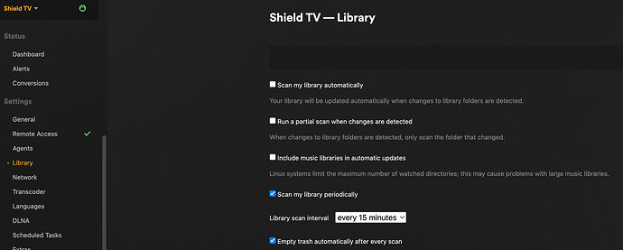

Here is how my Shield Plex is currently set up to scan every 15 mins:
