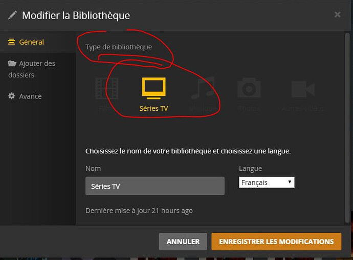

Also confirm that you created a “tv shows” category on plex2 and not a “home or other Movies” category.

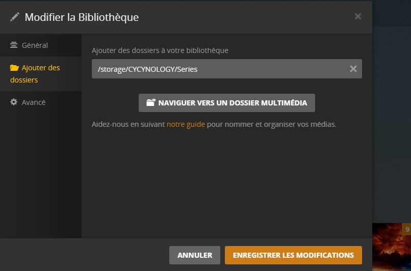

  1. please give the full path including an example of the file names.
  2. Have you confirmed, that your library is pointing to TVSHOWS and not to TVSHOWS\The Expanse ?

  3. I confirm that I created a “tv shows” category on plex2 and not a “home or other Movies” category, see below the screen is identical on PLEX1 and PLEX2:

  1. In fact, My Library “Series” is pointing to :

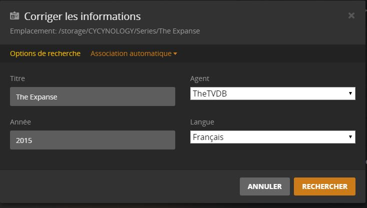

When I try to “associate” manually, I have the following screen:
as you can read, the Title is wrong… Of course, The Title is not S01 but “the Expanse”.
When I fix the title manually then the update is correct.
But on the next automatic refresh of this library, the problem is coming back…
I am becoming crazy.
I give you the same screen on the other PLEX on which all is correct:
Posting the last sceencopy I see a difference in the Path between PLEX1 and PLEX2.
So I reconfigured the same PATH on PLEX2 than on PLEX1 and now all is correct.
I think there is a bug in my particular case, because the path is correct, even if it is different (both paths are equivalent in fact).
