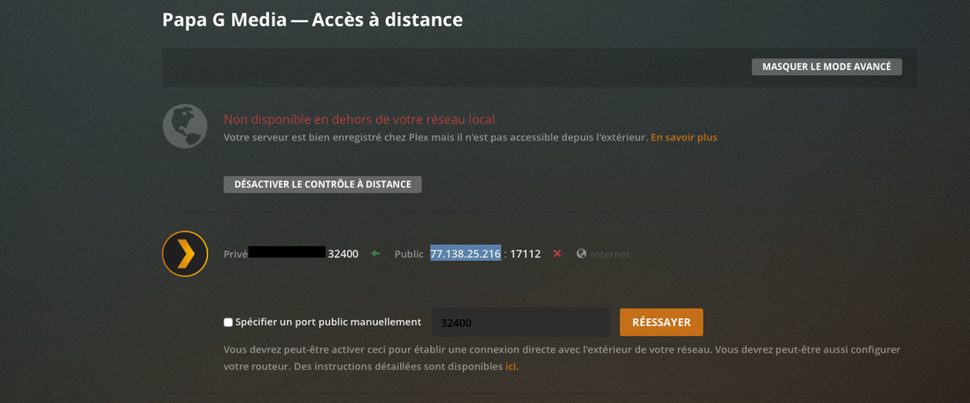

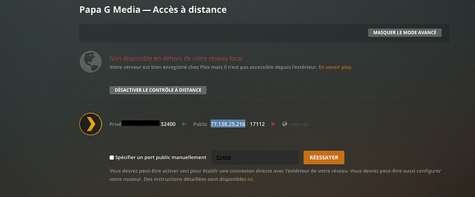

whether i manually force port 32400 or not remote access will not connect or pretend it’s connected for a few seconds and then shows no connection.

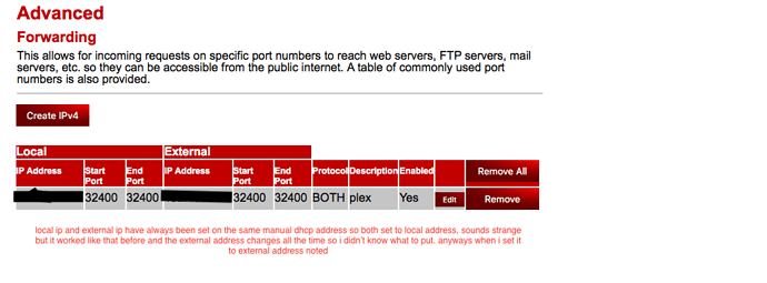

also joining photos of the router port forwarding.
Keep in mind that those settings worked perfectly until end of december.

one thing i can say is that for some reason i can’t see 32400 open on the open port check tool anymore…
not good enough with this kind of things to understand what is going on…
when i test to see if 17112 is open it says yes but i didn’t forward it on my router and remote access doesn’t work…

Your configuration is incorrect. To fix that, you can try any of the options bellow:
  • Enable UPnP on your router and then deactivate / activate remote access on Plex (recommended);
  • On Plex, specify the public port manually to 32400 and then deactivate / activate remote access on Plex;
  • Don’t touch your Plex settings, and on your router change external port start/end to 17112.
These configurations are not complementary, they are different solutions to the same problem.

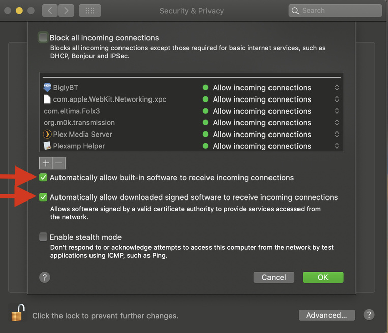

Type into spotlight “Network utility”, should be top of list. Check if your Public Forwarded port is open with port scan?
Go to your System Preferences/ Security & Privacy/ Firewall /options ( Admin access required)
Check if the following are enabled, these must be enabled Prior to Installing Plex Media Server as the Firewall Options pane will say Allow but in reality are not.
Last year I got sucked in on a security article and a piece of software suggesting not to have these enabled. The above was my solution.
Once completed and re installed the Plex Media Server, restart your Router and your computer and try to see if remote works.
